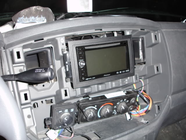

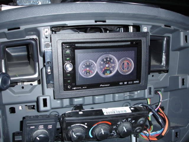

thank you very much. I'll snap a pic and show you what i've got as of now going.... if you care

Default RE: need help with recent install

you need the dash bezel for the ram with the navigation. I just did a similar install on my 07. check out my gallery. after searching on the net, including ebay, I found that it was cheaper to go to the dodge dealer and order a brand new one. it was $120 and I had it the next day. it all depends on what color your dash trim is, yours may be a little cheaper. The install kit you used is made for the navigation dash, I used the same one.

perfect, i just got off with my "buddy" that works at the dealership, he says i can get it at his cost.....sweet! (as far as color, i don't think i care, i'm going to paint it red to match. any thoughts on that?)
