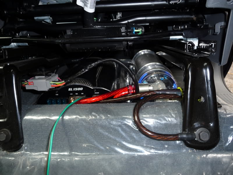

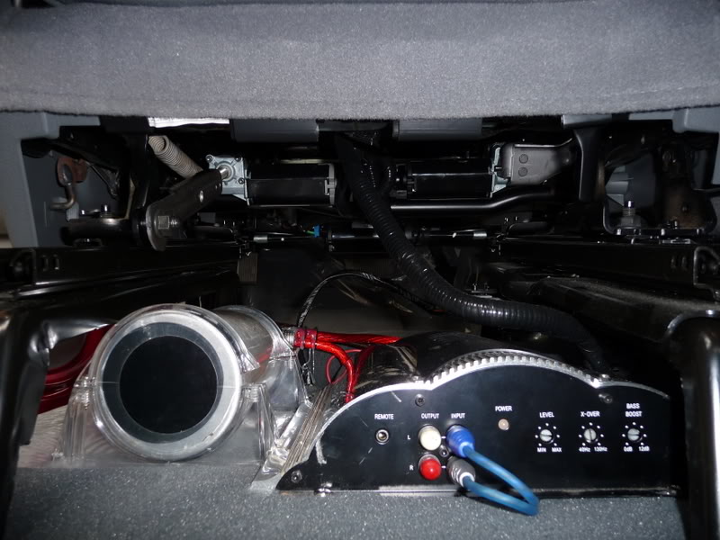

I started the installation of some extra bass this weekend. There really is no place to put audio gear if your planning on using all of the rear under seat space for music, so this is what i am doing. Please chime in with any suggestions.
I removed the front seats and put some plywood under the drivers seat to serve as a mounting point. To this I mounted a bazooka 500X1 amp that i have had for years and a voodoo 2.5 farad capacitor. I got my audio signal from a periferal chyaa interface. The green cable in the picsis just temporary to run tests. I have two precision power 122 dvc subs which will be mounted in a dual 12" box from fox acoustics when it arrives. I will post more pics as it comes together.

Yes that is hot glue on the terminals. Being that it is mounted under my seat I want the installation to be bulletproof. Just a little extra insurance that those terminals dont spin.

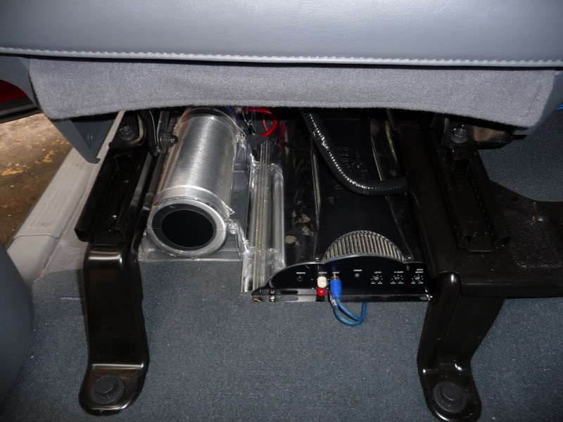

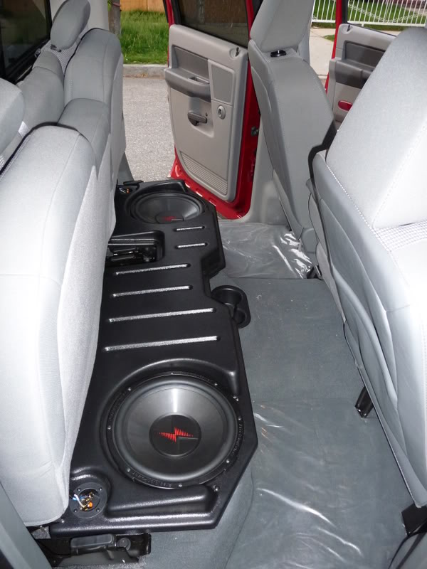

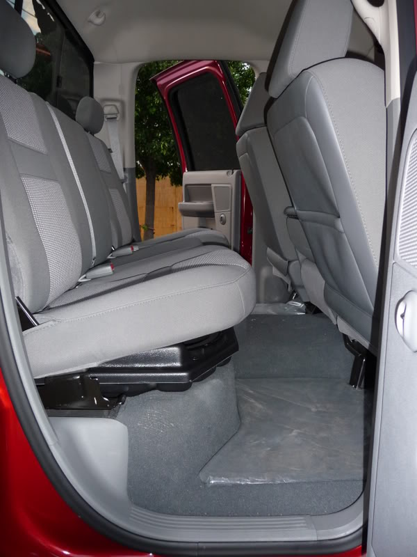

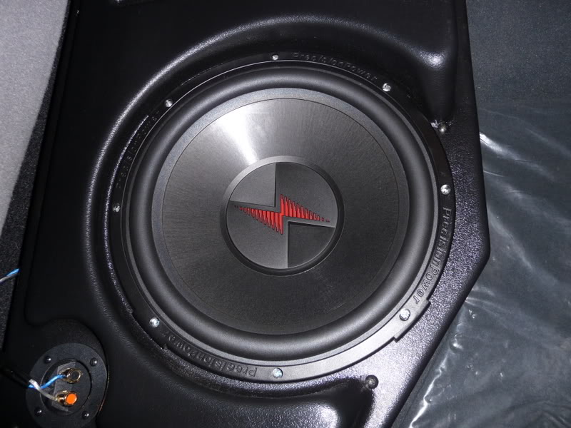

Almost done, just some fine tuning left to do..
I have to admit that the box sounds amazing for a box that small. They're dual 2 ohm coils wired in series and then parrallel, soI have a 2ohm load on the amp.
