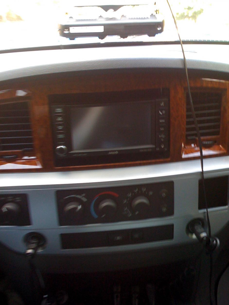

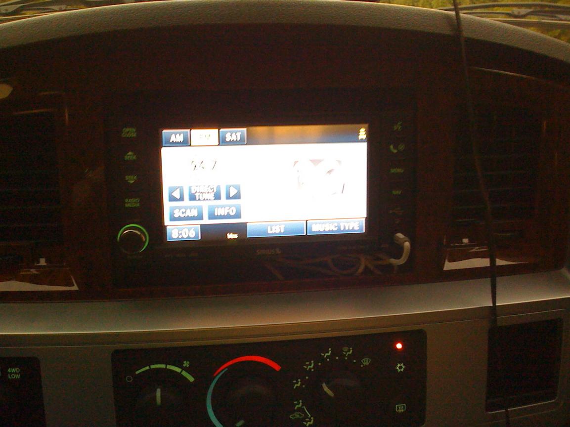

Hey Guys, It can be done.
Coastaletech finally shipped out the MyGig adapters and I got mine today and installed it. So far, I'm very happy with it. I'm getting the adapter cable for the Sirius antenna from the dealership (it's on order). Thats the only thing that is not working right now. It pretty much has seamless operation in the Rams.
Pics are attached.
If you have any questions just ask, I'll try and answer as best as I can.

are those gaps on top and underneath it? if so is there anyway to hide those somehow?
Yes they are gaps due to the MyGig being shorter than the REC Nav unit. I plan to fix/"hide" it by custom cutting some ABS Plastic to fill in the spaces. I don't have any ABS plastic laying around right now so I'm riding around with the gaps until I get some plastic.
i see. looks good and an in-dash navi system is very nice, looks really nice too man. just wouldnt want the gaps. but making yourself some plastic covers will clean it up very nicely. good work on the install. and as for the the antenna location, dont you stick it to the top, under the dash?
Yes you do stick the antenna under the dash. I velcro'ed mine to the top of the HVAC box behind the dash. I'm picking up plenty of satellites, always at least 5, if not more, I didn't ride around in Nav mode most of today so I wasn't able to see how many satellites I could get.
