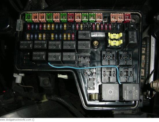

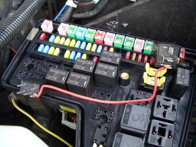

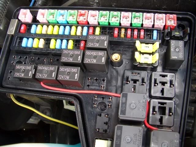

Here they are man... I did it, and it's wayy brighter!
