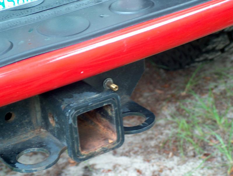

With the simple valve stem mounted I air 'em up with my compressor at the house, a small DC one I keep in my toolbox or even the local 7/11 when I need to, then air 'em back down when I'm done.

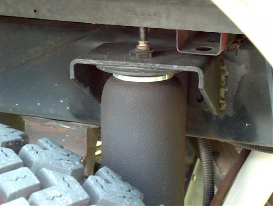

As you can see by the pic, I welded my bracket on. Only deviation I did from the instructions. The kit comes with bolts to bolt it on, but personally, I'd rather weld it than drill holes...
Attached Thumbnails Increasing payload on and 08 1500-hpim2897.jpg   Increasing payload on and 08 1500-bag.jpg

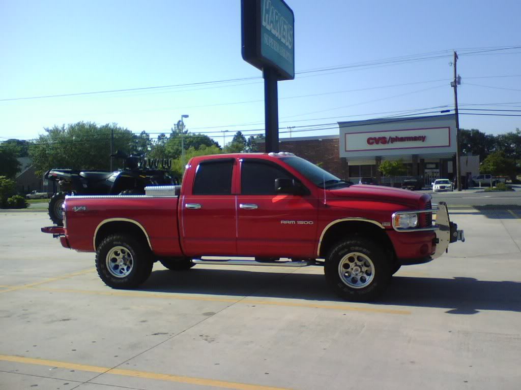

But I'll show you how far back the ATV sits with the toolbox and you'll see why I had to do something...
