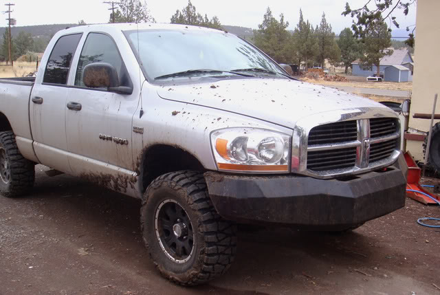

Yea i made mine, its not all the way finished but it is on the truck.
this is a pic half way through
ill post others when the rain stops

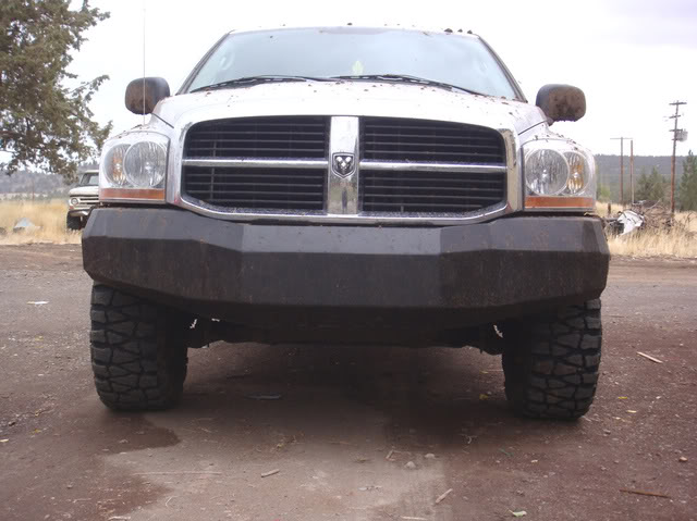

Well heres what it looks like sofar..
Eventually I want to wrap some tubing
up and around to protect the grill & Headlights..
Like the Road Armor bumpers..

Yeah I tried to follow the lines pretty close..
Paint is just a spray on rubberized undercoat(till its all done then Rhino)
Of course I will be making one for the rear sometime..
Front Center is 1/4" the Rest is 3/16"
Because i do plan on adding a winch, and heavy duty hooks
I do have HEMI Cut out in the Lower center, that you cant really see
in the Pics.. Im gunna put a piece on alum behind it so it stands out..
