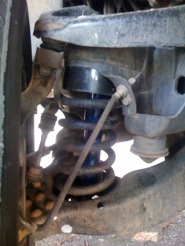

some people sell the 2" spacers for 2wd 06-08, search for them. I bought some for earlier years, but like I said, im having some control arm/spring bucket contact. The kit I bought actually says for my year, but then if you look at the very bottom it says 06-08 could have problems
atticus keeps posting what he bought, but its irrelevant if you have an 06-08. The earlier models have skinny control arms, and we have more of a pressed piece. Name:  1264538443.jpg
