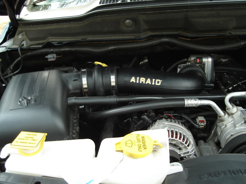

That's what I did and I love it. Sure there's better CAI's out there but for the money you can't beat it...even the Truflow is over $250. Here's a few pics from my truck. If you get the filter with it the cost is around $160...the tube, couplers and all hardware is $110.
Just a little heads up incase you decide to go this route. The hole for the IAT sensor is on the back side on the tube. This makes a cleaner install but you'll need to get at least 4" of slack in the IAT harness. You just have to cut the factory tape and pull some out of the heat shield thingy and retape. Simple..
