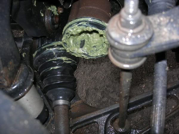

1) SFA = Solid Front Axle.
2) As opposed to a IFS or Independent Front Suspension (ie. CV Axles).
The former gives more of a solid, unbreakable (well I've busted a few) front end platform. Found on 2500 & 3500 Dodge Heavy Duty Trucks and the 1500 Mega Cab.
The latter gives a much more car-like ride, especially at highway speeds, over bumpy roads. But take a CV Truck off road, run it hard, especially with the burden of bigger tires and this is what you get (trust me, I've changed out a couple of busted CV's):

You just like busting **** dont ya?

Every chance I get. What more is there to life than bustin sh*t, then fixin' it???
