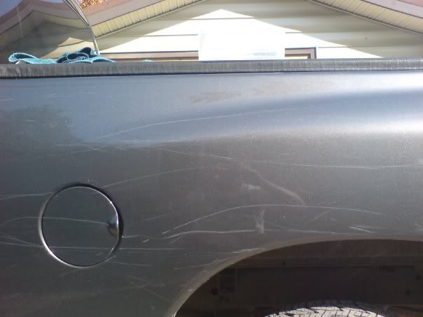

also does anyone know of some realy good scratch remover i got tons of scratches the other week when in the woods there not deep just on the clear coat you know made it go white anyways i tried a few things this one stuff worked really great everyting was gone untill about 2 weeks later it all started coming back and i even waxed my truck do you know if theres any long lasting stuff ?

screw scratch remover. go get you some rubbing compound.

yep, rubbing compound, polishing compound and a good buffer...
and that will actually get rid of them and not just hide them for a few days that would be awesome i love this forum it seems theres always an answer to almost every question

Rubbing compound works like a very fine sandpaper, by gently smoothing the vehicle's paint by "sanding" scratches out of it. When the compound is rubbed in, it smoothes the edges of the scratches and evens out the surface of the paint. This, in turn, removes marks and minor scratches from the paint's surface. Once filled, the scratches appear smooth and are no longer visible. When coupled with a colored wax that matches the vehicle's paint, rubbing compound can almost completely eliminate deeper scratches or at least make them less visible.
But remember, think of the rubbing compound as a sand paper, so DO NOT OVER-DO IT!!!

As far as the scratches, like others have said rubbing compound works well if you use it sparingly (not too much) otherwise, you can take it to a body shop and have them wet sand out the scratches, but make sure you wax after you're done.
