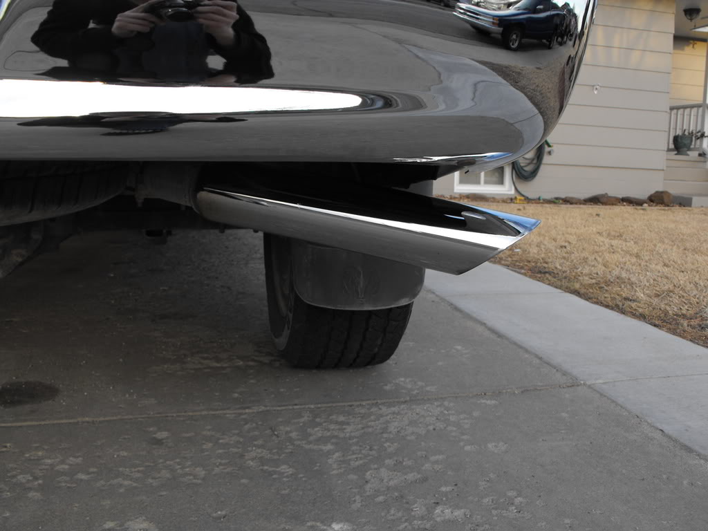

Which angled setup for the exhaust are you talking about?
You mean like that under the muffler or somewhere else? If it's there, I can give you some help on it, I have duals, but not true duals.

Thanks guy i will be sure to tell him to run 2 1/2". severdistortion, i think it will probably be an h pipe, i forgot to ask him the other day so i will find out for sure today and get back at you. ried69 it will be 45 out the back then kicked down about another 45, they call this cowboying the pipes. saw it on a tahoe that looked really nice. The tips will shorter than a standard length 4" tip, this way he will be able to kick the pipes down. oh this will be from the cats back.
