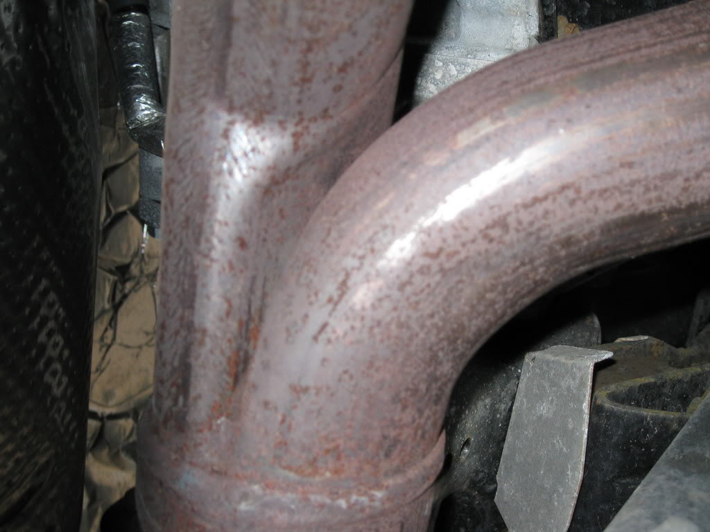

The 08 is different form most others. It does use a pair of high flow converters from a different supplier then 07-back Hemi's and the Y is after the converters like most others. There is no front resonator on the 08 just a muffler and rear resonator.
My stock system flows pretty darn good by looking at the morning condensation coming out.
There is room for flow improvement at the front Y where is is partially crimped to put the two into one. I am going to go with the Magnaflow cat-back and leave it at that when the kit for the 08 is finally released. It is all stainless and will last the life of the truck, unlike aluminized pipe which is good for 5 to 7 years before the seam rusts away.
Here is the y in question:

cool that is the y pipe in question and will be gettin rid of mine soon hopefully.
