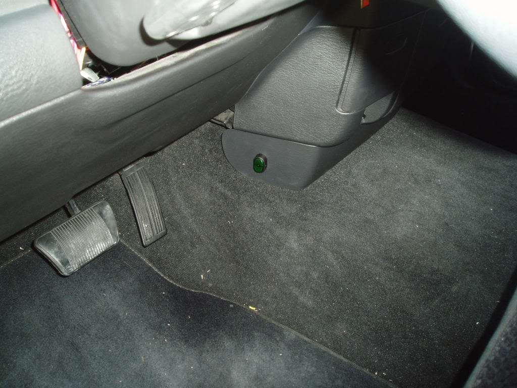

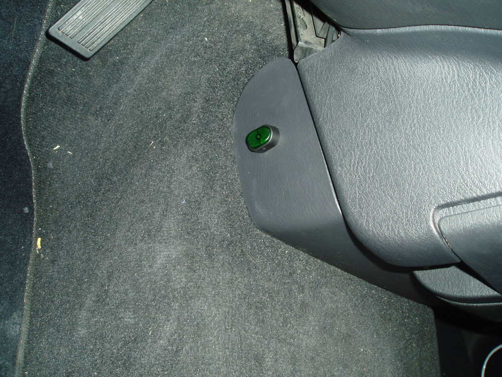

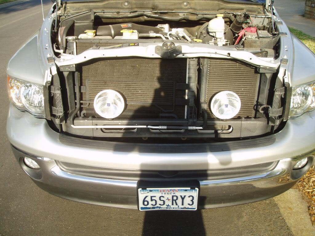

ok well i installed my hellas or atleast tried too. i followed all the instructions and thought i did it right but they will not turn on. any advice please...

have you double checked all the fuses? all the connections, and double checked all the insturstions
did you run a wire to the highbeams or not?
if not you need to run the green(if i remember right) wire to the hot post on the battery

i double checked all the fuses. i did not run to the highbeans you can see in the second pic i run the green wire from the relay to the switch. is that wrong? the red wire is from the battery to the relay...

Dont use the wire color codes they could be wrong because the colors were different from what my instructions said. Look at the bottom of the relay you will see numbers.
#87 goes to the Hellas
#86 goes to the high beams
#85 goes to ground
#30 goes to positive battery terminal
Can you hear the relay clicking???

ok i have my ground wire on the crossmember. all my wires are wired like above but i didnt use the highbeams just the switch. i dont know what to do...
and no i cant hear the relay clicking. it doesnt make any sound
then the highbeam wire should be connected to the postive battery post.
