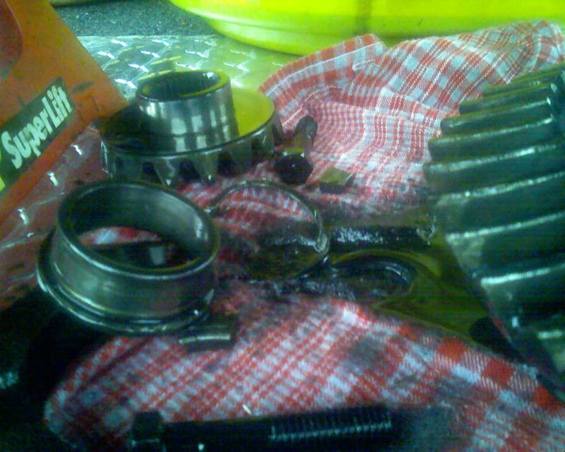

A ring and pinion will not go bad or break until you put over 1000hp to it.
Anything under that is caused by bearing failure, which will do things you couldn't image to a rear.
I had a carrier bearing go bad in a Corporate rear. It took 5 thou off the carrier end, took out the other carrier bearing, and broke about 10 teeth off the R&P.
Here's what was left of the bearing.
