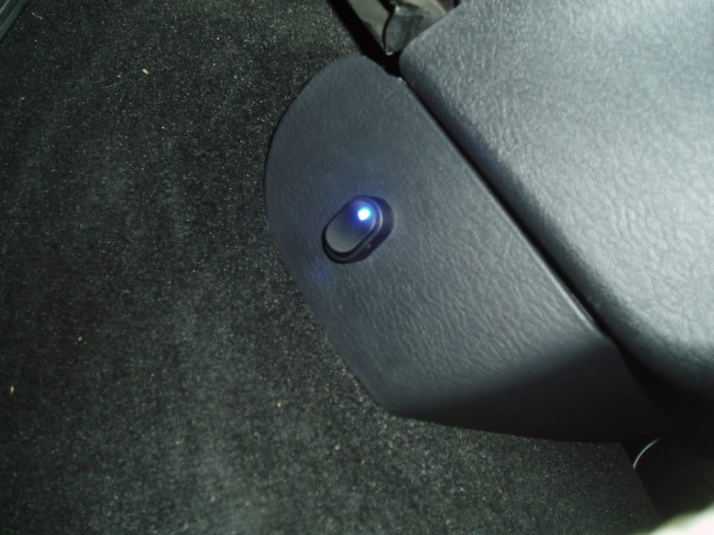

man thats exactly were i put mine...

Old Apr 1, 2009 | 11:58 PM
gonzzo23's Avatar
gonzzo23
Joined: Jun 2007
Posts: 27
From: Corpus Christi,TX
looks good silver I haven't seen any body do one there before thought it would be different. I'm going to put a spare in also planing to do an electric fan down the road.

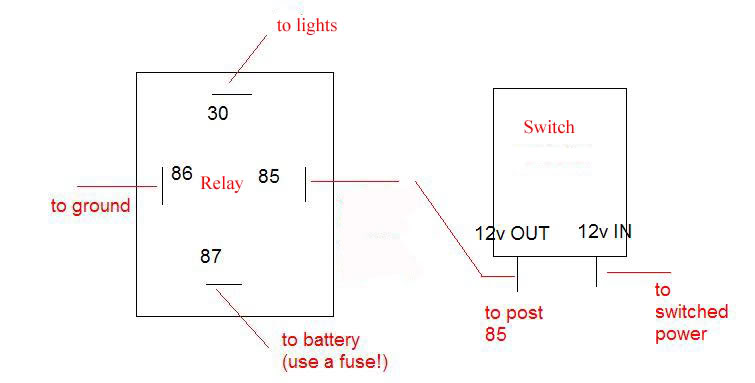

Do NOT bypass the relay and run all that power through your switch. You're just waiting for an electrical fire. They included it for a reason, so don't be one of those guys that has to learn everything the hard way. The switch isn't made to handle the current draw of the lights for any significant amount of time. It will eventually fail and they are known to catch fire when that happens.
Here is a schematic of how to wire a four post relay. It's easy.
