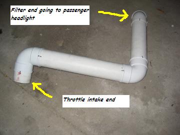

So, you used a flexible rubber 90 degree bend?
As far as the 4.7 hat...here is what I have made so far. I am debating taking the one 90 degree out and putting in another 2 - 45's so that it isnt such a sharp bend. I dont know how much of a difference that will make though since there are tons of crazy bends in the stock system as it is. Not to mention the corrugated flexible tubing they use that cant be all that great for airflow either.

Also, I am using a PCV grommet from a Toyota to hold the AIT sensor. It seems to fit perfect.

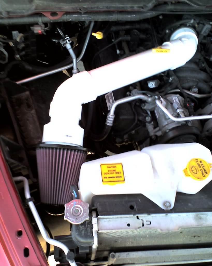

try to not make so many bends.. the less tubing the better the air flow.. i just made mine over the weekend heres what mine looks like.. (not painted yet) your truck will sound so bad *** when all completed and on..
Looks good! Did you need to support it at all?

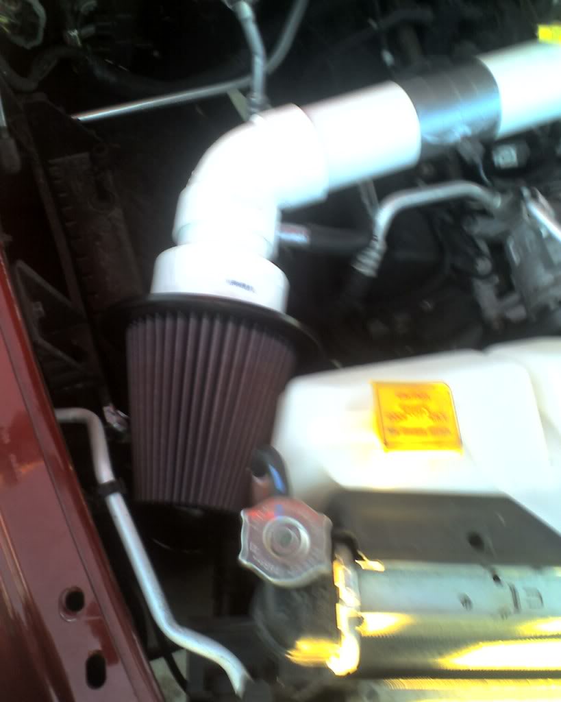

I added a support bracket to mine: Check the left side of the pic....I used a steel/rubber exhaust mounting bracket from autozone.

the rubber on my filter keeps it proped up.. there is absolutly no movement to the intake so i didnt have to make a support.. i have no problems at all
