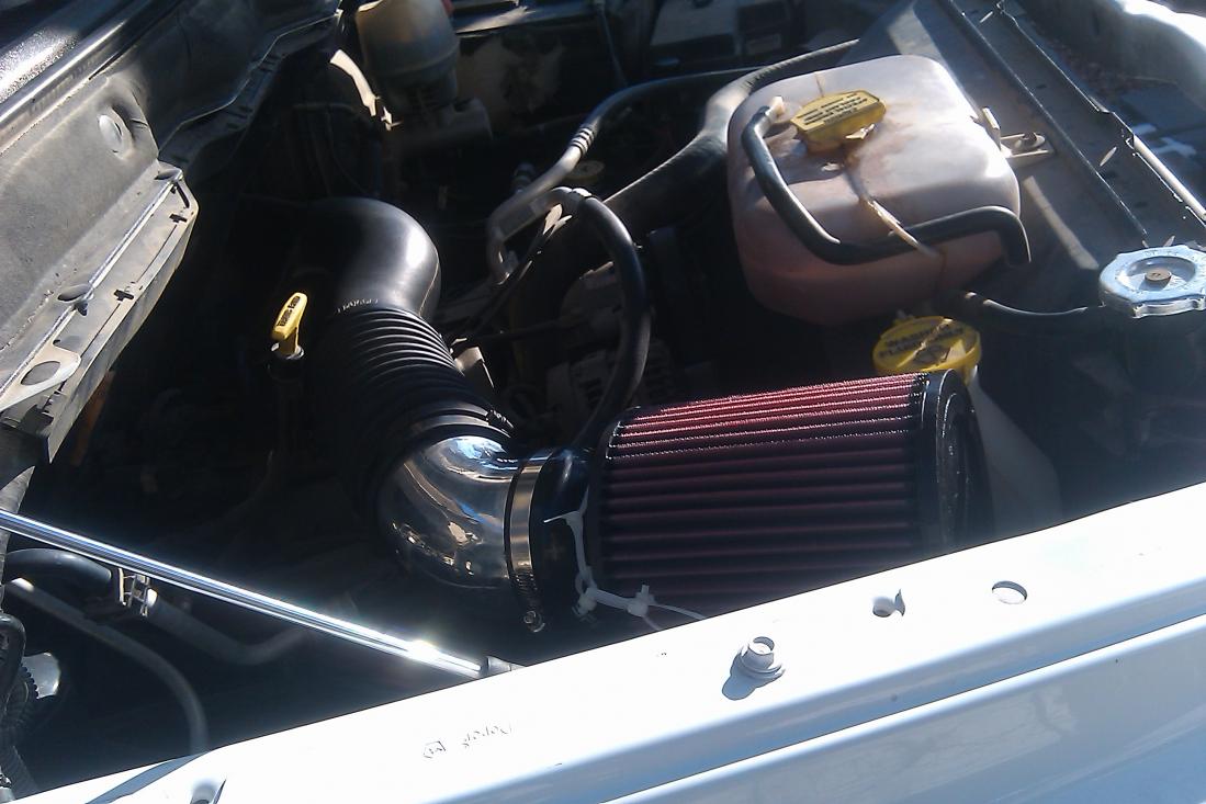

Posts: 10
i did this last night... nothing fancy.. but better then stock...
