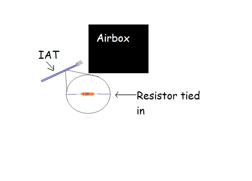

Go to radio shack. Buy a pack of 4.7K ohm resistors. 1/4 or 1/2 watt, either one. Bring them home, remove one (1) from the package. Find the IAT sensor that plugs into your breather, it is a small plug with a gray plastic connector and two blue wires coming from it. Only sensor going to it, cannot miss it. Cut one (1) of the two (2) wires that come from it. Either one, doesn't matter.
Tie this resistor into the cut wire. Then tape it up. You are done. View the very detailed image below:

nice drawing you got there very easy to follow
