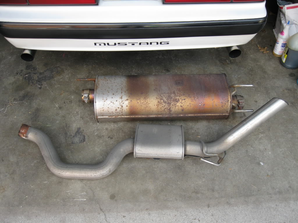

Probably more torque with the 2.25"
The 08 is all 3"
