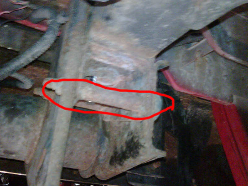

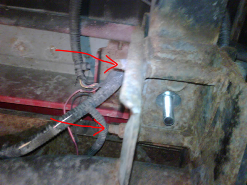

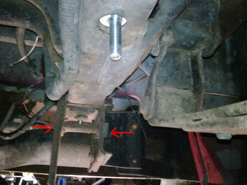

so, the hitch arrived today, and i tried installing it...
i will save you other troubles, but the hitch doesn't fit...
i attached pictures. there is something in the way. i guess i'll try returning this one and get the small one and weld the fourth mounting point. as of now, i'm out of other ideas... doh!

i talked to the curt customer service and they say the part shouldn't be there.
can you please take a pic of that part of the frame for me and tell me if you got the same thing there? maybe i can just remove it, if i ever get thru the rust there...
i'm trying to find some pictures online, but no luck so far...

this is the picture curt's sent me. i think it looks a lot different than on my truck.
if you look at one of my pictures, there is a tube actually covering this part, that's why i took pictures facing the rear of the truck.

Who knew it would be this hard. Most of us are just '02-'05 looks good, I'll take it.
I just looked at the pdf to install the small hitch,your pic and the curt pic and I would have to say yes it looks like you have a tube bumper. I'm assuming now that's why Curt list two different frame mount hitches for long box trucks in the second pdf I posted (13361 & 13330). When you use their quick guide app on their site it only lists the 13361. It looks like the 13361 is for long boxes without the tube bumper and the 13330 is for long boxes with the tube bumper. You'd think with two listed they'd have a note about the tube bumper just like the note about Rams built before Nov. '02.
It looks like both your choices for hitches use the same bumper mounting points. If I knew for sure it was going to fit I pesonally would still go with the 13330 eventhough it still uses the bumper mount points. It still has 4 frame mount points and then I would just re-drill the bumper mount points so the holes in the bumper and the hitch are the same size and then just get some larger proper fitting bolts. Then again I guess you could do the same on the small one and you wouldn't have to worry about whether or not it'll fit.

I was looking at your old pictures again and it almost looks like a tube style hitch you have there already, could you post a pic of the whole under bed/back area so we could see better,it's hard to tell what your looking at from the close-ups.

No, it's not a tube style hitch :-) there is no hitch, but i'll post a pic if you'd like!
i called Dodge. they say that depending on the bumper (step or not) the bumper underneath is different. either a tube style (like mine) or not.
So, i guess that's why everyone is carrying just the small hitches...
