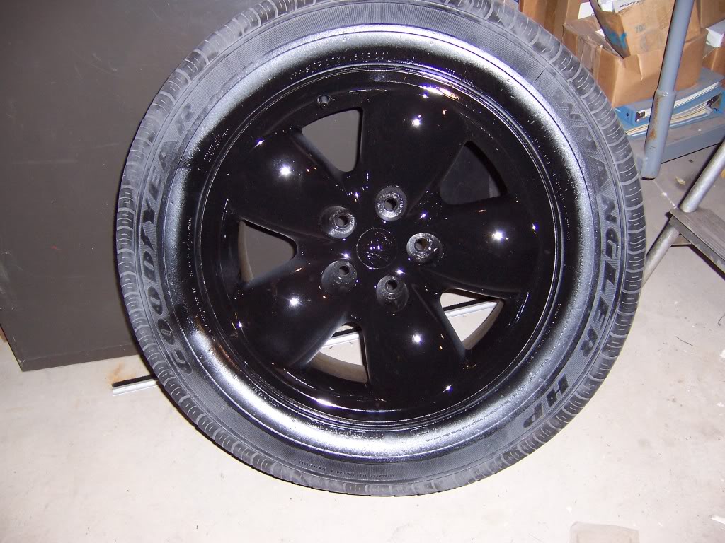

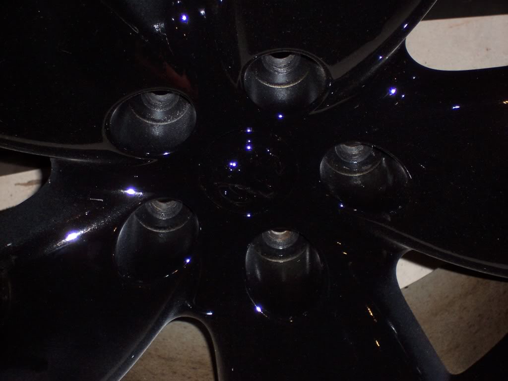

Originally Posted by tuned93
im just gonna sand the chrome off the plastic coating and spray em black... i cant wait to put them on!!
painted-
in these pics dude I havent even wheeled the paint yet and it still looks amazing the only hard part is sanding that effin dodge center ring thingy i used sand paper wraped around a popsickle stick and a dremmel tool be careful with the dremel.... use a power sander on the main parts of the rim 300 paper should be good enough for the edges and what not do it by hand it takes a couple hours if u do it right but its worth it and paint that thing slow i took a week to paint mine i used two coats of primer then wet sanded it then two coats of black then wet sanded it then cleared it 26 times

Originally Posted by 2005cobrakiller
painted-
Did you really paint the wheel while it was still on the tire?
