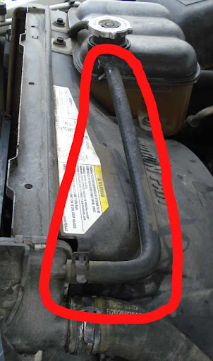

And lastly, there is what seems like an overflow hose that feeds into the reservoir from the upper coolant hose...there is a constant flow from that hose when the engine is running...is that supposed to be like that?

Also....this hose is constantly spilling hot coolant into the reservoir, so for that same reason I am thinking that the radiator is blocked up....
What do yall think?
