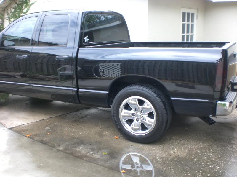

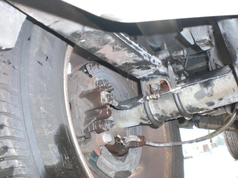

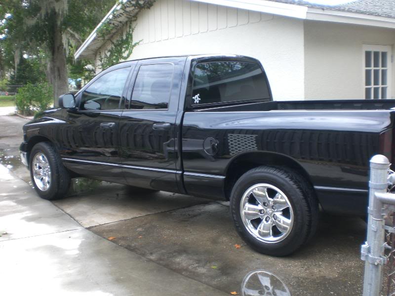

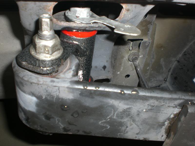

ok here are some new pics of my truck i put on a set of djm drop shackles suppossedly 2" and i also removed my overload leaf now my truck sits almost level 36" in the front and 38" in the back thats measured in the center of fender well its the way i was wanting it to sit it was not difficult but i didnt really know what i was getting into but once i had one side done the other went quick.....so here they are
heres the shackles.....

no overload leaf.....

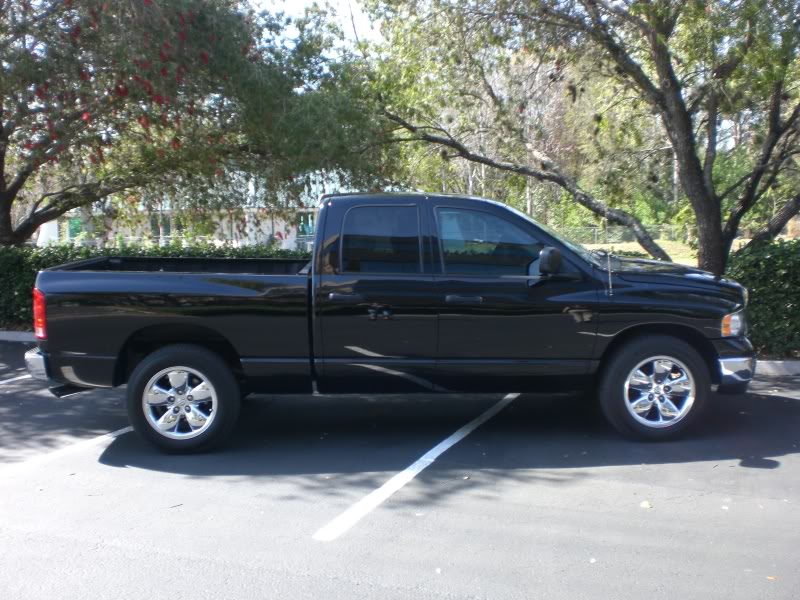

a before pic.....

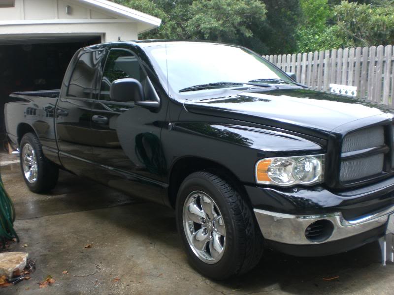

and here are some after shots.....

Nice ride, looks good. What Grille do you have?

its a "guttah grill" i used a gutter gaurd material from home depot i have a diy thing in the faq section go check it out and i got better pics in my threads if you check there...

so all u needed were the 2 shackles and blam! the rear end lowers. did u just use floor jacks and installed everything on your own.
ive been wanting level out mine too
Old Jul 20, 2009 | 09:40 AM
BadHab1t's Avatar
BadHab1t
Posts: 5,930
From: TAMPA BAY
yes i used 2" drop shackles and i used two jacks to do it it really easy to replace the shackles but i also removed the overload spring cause the shackle only get you 1.5" and the removal of the overload leafspring gets you another 1/2- 3/8 of an inch lower i did this all by myself in my driveway if you need any help just ask me ill direct you the best i can....you can get mcgaughys drop shackles from moesperformance.com for 75 shipped.... i got mine from tuned93 here on the forum
