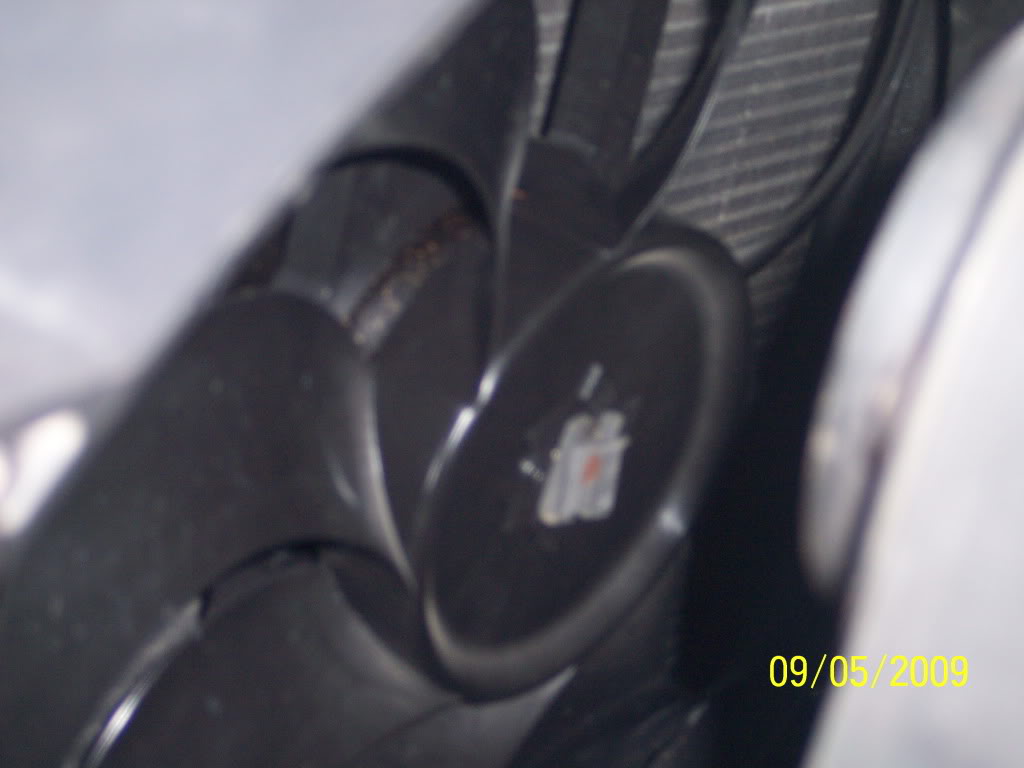

I have seen the DIY's I am just curious about how it looks if anyone would snap a shot of what the taurus and/or 180 extreme looks like.

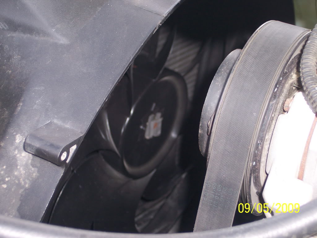

Here are a couple pics. The first one is just a generic pic of a Taurus fan off a 3.8 and the second is a pic of the fan installed inside the stock shroud. Sorry that I don't have a better pic of it installed but since it is inside the stock shroud it is hard to get a good pic of it.
