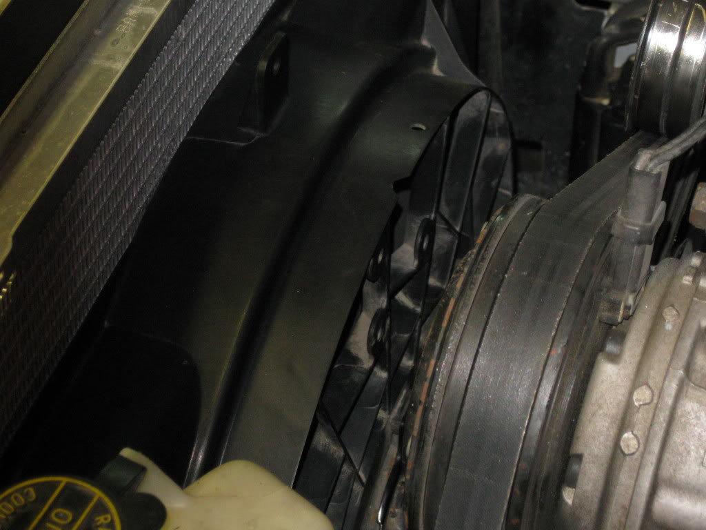

I think 88-95 works. Mine is actually off of a 89 Lincoln Continental which is the same thing. Gave about $15 dollars for it at Pull-A-Part with warranty I think. Needs to be off of a 3.8L car, not a 3.0L. Must be popular because my Pull-A-Part had had all of the 3.8L Taurus/Sable fans already gone and all of the 3.0L were still there. I guess they didn't know that the Continental was the same platform with the same fan.
