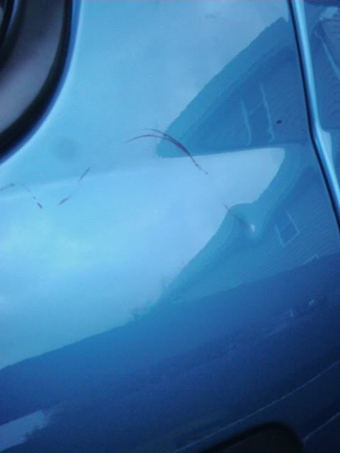

Heres a pic of the scuff. I think its just plastic from the mirror but idk.

Most of the replies work fro most of this WD-40 great for such things if worried about surface or astethic damage try on inconspicous area first lol like carpet cleaner directions!!

I tried the WD-40 and rubbing alcohol combo on the wax and the black mark. The wax is history but the black mark didn't budge.

paint thinner... just take it easy, dab it on, let the solvent do the work, then wipe it off. dont scrub the **** out of it. we used to use it all the time at the detail shop i used to work at. worst case scenario you just run a buffer over it..

The zaino rubing compound works wonders for scratches and scuff makres
