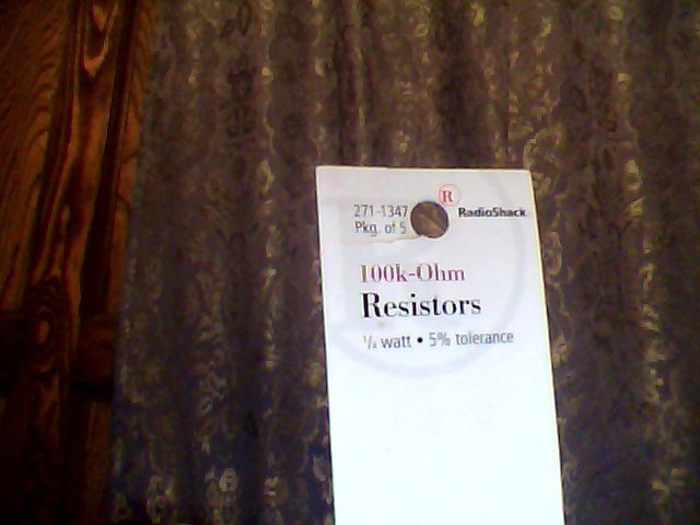

will this resistor work its 100k-Ohm 1\4 watt 5% tolerance
Attached Thumbnails my home made power wire/pics-snapshot_20120824_1.jpg

No. Use the specified 4.7k resistor as directed

WindowShaker, you could prob use 100k resistors. The Ram will onyl read so low for temps. I think outside of 10kOhms, it doesn't read anymore so you could certainly try the 100k but it might not work as well as the 4.7K
The greater resistance, the colder the Intake temps are read.
