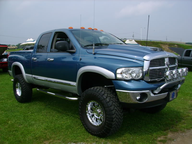

I have a 3rd gen with 9" of lift, my suggestion would be go with the 37" tires, you will want to upgrade the gearing on it. And yes, you can get 4.88's for them. When I had mine done 2 years ago, they were just coming out with them for some of the Dodge trucks but did not have any available for the 3rd gens yet, so I had to go with the 4.56's.
You can get a programmer and reprogram the computer on your truck. You take all of those factory settings off of them, that will really open these up and they will run much better.
