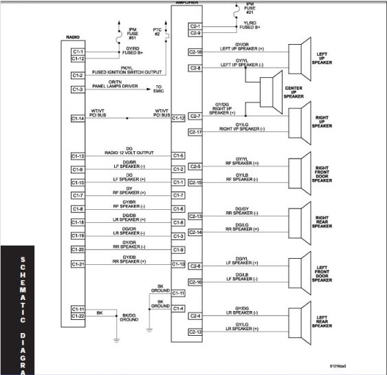

if u can send a pic of the how u wired them that would be awesome im tryin to figure out where the stock amp is so i can disconnect it and re run all the wires

i just tied into the wire harness that comes off the back of the deck. do you still have the stock deck? i would bypass the infinty amp if you have that set up it is pure ****. here is a diagram of the wire colors for the stock set up

i have an aftermarket deck in and i got aftermarket speakers all away around except for the tweets i might steal your idea. but the 6 by 9's in front you can barely hear them in my truck and i think its cause of the stock amp. thanks for the diagram

and Kamel it probably is the amp, that thing is pitiful. a lot of people have done it and i will suggest it run new wire and bypass that thing all together. i got the rockford fosgate 16g awg wire at best buy for 19.00 for 30'. you will need about 50' i used more planning on my amp wiring.
