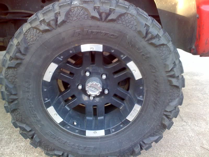

I see your point about cranking the torsion bars. Do you think that if I got just a leveling kit the truck would fit those 35s without a problem, or would I need to do more than that? Can you combine a leveling kit with a body lift, or are they basically the same thing?

level for you is basically the same as cranking the tbars. it will only level out the truck. so if you do a bl too you will be adding 5'' on the front and 3'' on the back which is what dedogg has done.

v leveling kit, 35s, say goodbye to "effortless merging" lolz. what kind of tires are they?
same ones you have lol
