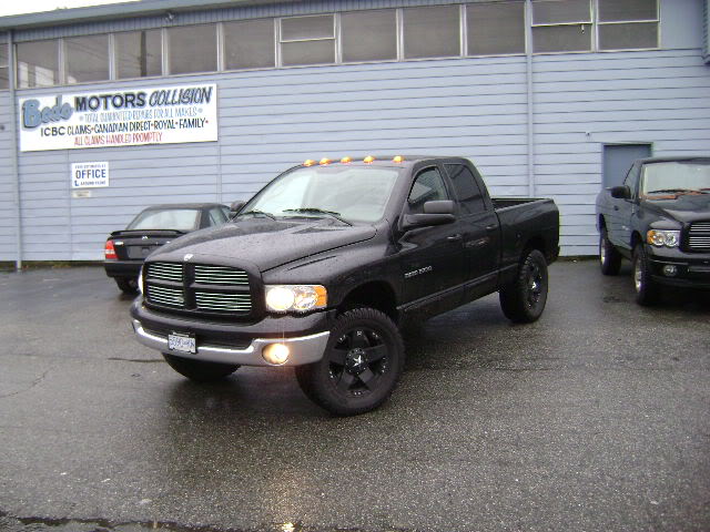

thanks for the info and yes my truck is a 4X4, i think im going to try it with the level kit in and see how it works, maybe throw a one inch block in the rear if my truck is looking up at the sky.
here is my truck right now (before pics)
