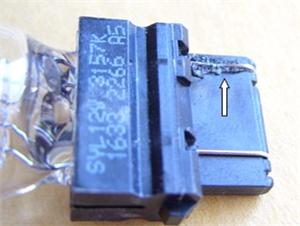

I went through this for about 3 days before I figured it out, I hope.
My story is the same, light would come on and ding intermittantly. Reading on here, I found mention of lights setting off the "lamp out" light that weren't actually burned out. I found the 3rd brake light was black, then after more dinging, I found one of the license plate lights black. Both still working. I replaced them both and still intermittant problems with the warning light.
After it finally sank in that the "lamp out" light would come on and than go out when I hit the brake pedal, I pulled the rear lights and circuit boards out. When I pulled out the circuit board on the rear lights, the lights all looked good. No black and the filaments looked ok. When I pulled the brake light bulbs The pic shows what I found. I am not sure if that was because of a bad bulb or the loose circuit board like rcalbat said.
I am hoping this post will help someone with these problems.

Old Feb 10, 2010 | 04:39 PM
dirtydog's Avatar
dirtydog
Moderate User
Posts: 17,003
From: Albany, NY
Sounds like a bad contact on the bulb itself.
I am hoping this post will help someone with these problems. Attached Thumbnails
I am having this exact problem. I have replaced the bulbs at least 4 times in my rear right brake light. Is it the entire board or will a good cleaning help the problem?
