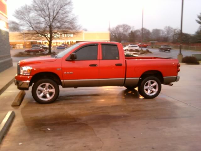

well guys, i finally got around to putting the kit on this weekend, well, half of it atleast. it tok us 10 hrs to put those damn spacers in the front. ive never in my life seen bolts with so much loctite. the rear will have to wait until we get another free saturday. we got one shock off and just decided to put it back on and wait. the truck is level now though. the directions say 1-3 hrs to install. that a bunch of bull****. we went and got a spring compressor and it didnt work, so with a ratchet strap and some muscle, we got the front struts back into place. now it needs an alignment and it'l be good until next time. here's a before and after.

Old Dec 13, 2009 | 11:33 PM
4.7Ram5.7Rango's Avatar
4.7Ram5.7Rango
Posts: 982
From: Lynchburg, VA
Looks good, but not quite level imo. Maybe 1" blocks would be better in the rear now? Plus, not too sure, but maybe the spacers will 'settle' a bit, bringing'er down a bit.....
Regardless, it looks better for sure. I can't wait to b!tch and complain while doing mine
