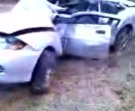

I used to be so scared to drive in the rain, bc I almost died in a car wreck back in Jan 2008 caused by rain, that I wouldn't drive without the truck in 4wd if it was raining out...Nothing ever went wrong from it or anything, I just didn't drive too fast.
Size:  17.0 KBit wasn't a convertible, they had to cut me out of the car lol

Holy **** thats an accident! Everything turned out ok? What did you hit?
