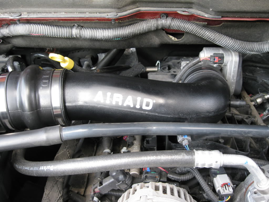

So if I were to put a CAI on there in the future, would that hose still need to hook into the CAI some place? I've seen where you plug the IAC sensor into the CAI but I don't think I've seen anything about that hose having to be connected to it. Just wondering since a CAI is possibly one of the next things I do to the truck.

Yep. You need to filter that air that is being drawn into the crankcase somehow.
The Airaid MIT pipe has a spot for the hose on it. It's on the right side of mine in this pic. I still have the factory air box, so I capped it off.
