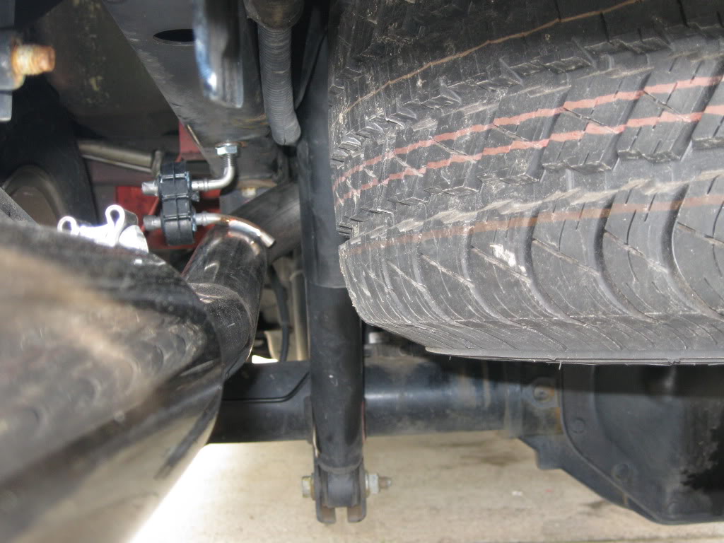

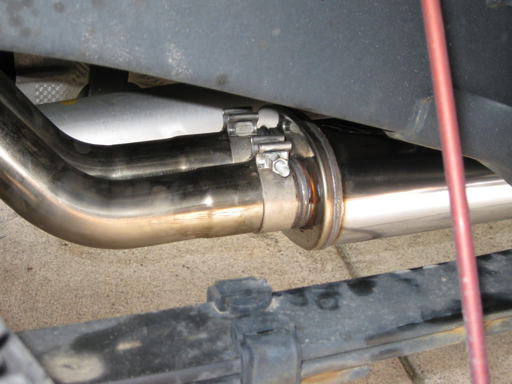

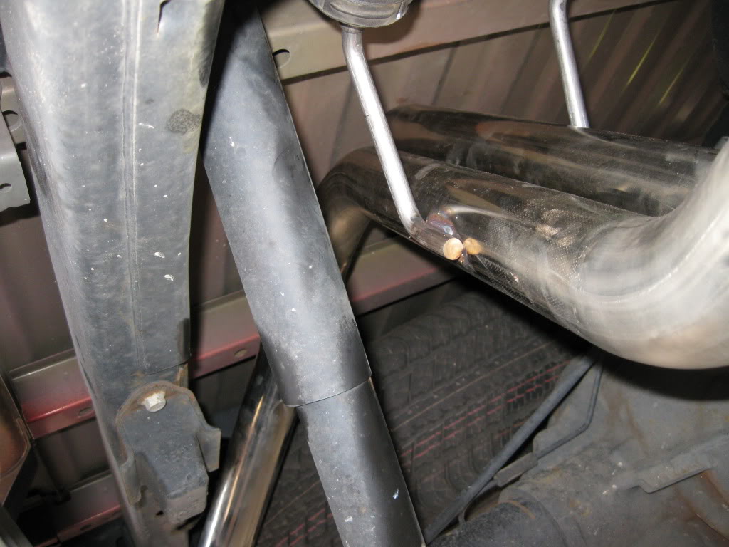

That's what I have on my 08. Took about 1 hr to remove the old and install the kit. I didn't have to use the straight mid pipe because in 08, they eliminated the front resonator.
