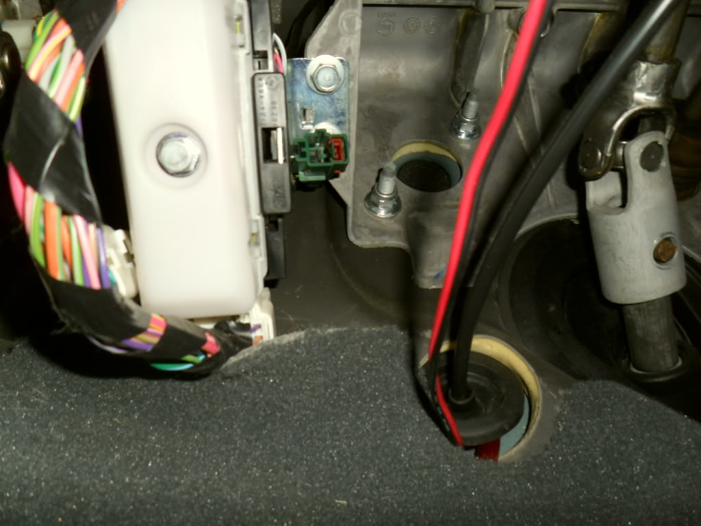

How did you wire your electric cut out?

Old Jan 5, 2010 | 08:15 PM
Matt99's Avatar
Matt99
Posts: 4,210
From: Shreveport, LA
yea thats it, but instead of leaving that plug out, i slit the side a little bit so you can get your cables to the middle, then when you push it back in the plug kinda squishes the two rubber sides together

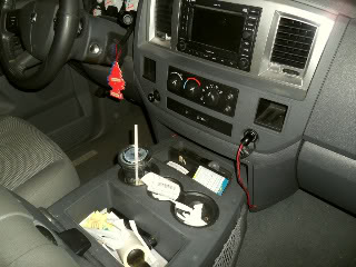

Old Jan 5, 2010 | 08:20 PM
bighornram08's Avatar
bighornram08
Joined: Apr 2009
Posts: 178
From: Dfw,Texas
Size:  22.1 KB Hid the rest of the wire behind the dash. I finally figured out how to post pics from photobucket. Dont really know if they are too big, if so, how do i fix the pics.
Old Jan 5, 2010 | 10:22 PM
02Steve1990's Avatar
02Steve1990
Posts: 2,343
From: CT
any pics with a broader view? Hard to tell where that is on the truck in the first pic. I would like to plug the adapter in the center console, if not I can go out and buy a three plug adapter so I can use several other things at the same time on the main by the 4wd shifter.

Originally Posted by bighornram08
OUCH!!!! You are just tearing those cable up on the firewall in your truck... rerun your wiring through the plug before you burn your truck down please!!!
hmm I wonder if I have a bare wire there, I do have a bad draw
Old Jan 5, 2010 | 11:09 PM
bighornram08
Joined: Apr 2009
Posts: 178
From: Dfw,Texas
what wires are you talking about. The red one is my speaker wire. The red and black wire is the cutout wires
Old Jan 5, 2010 | 11:11 PM
bighornram08
Joined: Apr 2009
Posts: 178
From: Dfw,Texas
I didnt know that these wires were any fire hazard. How?

Old Jan 5, 2010 | 11:17 PM
matthewbeard's Avatar
matthewbeard
Joined: Dec 2007
Posts: 372
From: Ellsworth AFB, SD
i cant get the pic to load on a DoD computer but i'm guessing hes talking about not having a grommet or anything protecting the wires from bare steel. chafing will happen and then a short then a fire.
