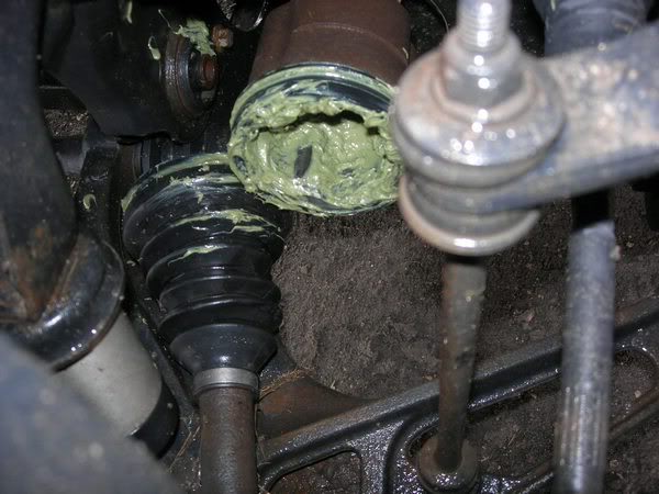

Cheap lift + 37" tires = broken CVs, even on "pavement queens"...

DAM hammer that is a painful picture!! UGLY!!!!
