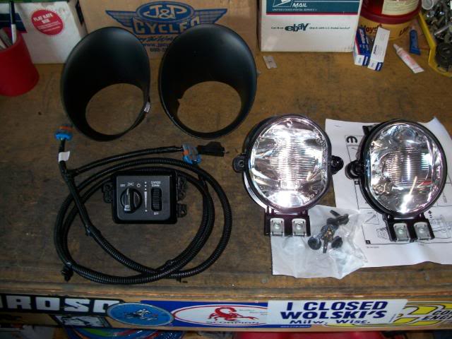

Ordered the prewire foglight kit from a mopar dealer on ebay. I think this entire install took me 20 min and that was with taking pics.
1st...what's in the kit.

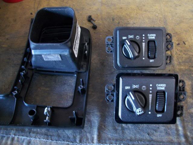

Old and new(provided) headlight switches

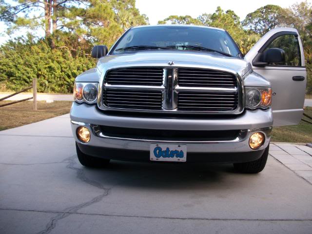

And we got power!!!
