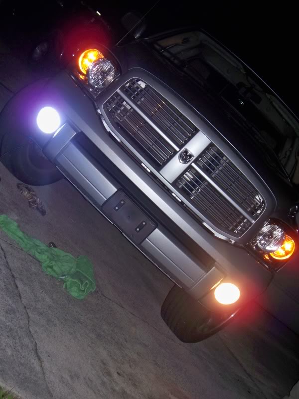

Well I finally took a break of rebuilding my mx quad and installed my 8k HIDs in my truck. I get compliments pretty much EVERYDAY cause they look so clean and good, I love them! Looks WAY better than my friends ebay HIDs, I got to find a spot to put there decal on my truck haha. But I do have 1 question I think I did something right.. They are adjusted perfect but when I turn my brights on they just go straight to the ground? Does anyone know how to solve that?
2nd Pic is a Cell Picture I'll get a better one later, got a new Camera might as well try it out lol.

There have been cases where the lights are wired backwards from the manufacture. When you think you are buring the highs you are actually burning the lows and so when you go to use what you think are your high beams, instead of the lights moving up some, they go down because you are actually switching to your low beams.

Could the lights be installed upsidedown? I know that was a dumb question haha
