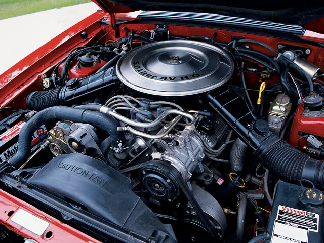

Open element old style filter = HAI Hot air intake
Get a dual horn air cleaner assembly from a 83-85 Mustang GT then run both cold air tubes to the front of the truck.
Like this

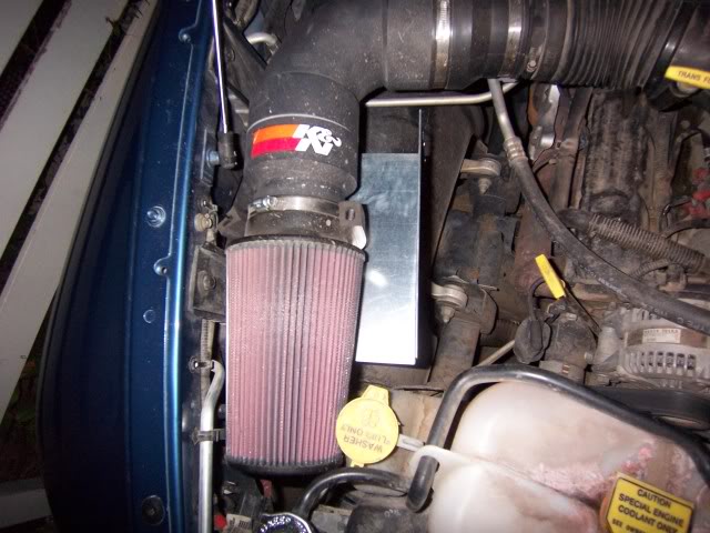

Shiloh- can you take a pic of your intake please? I just want to see how it is set up.
Old Jan 29, 2010 | 01:54 AM
Shiloh 24's Avatar
Shiloh 24
Posts: 1,956
From: El Dorado, Kansas
Heres a couple pics of how mine is set up. I just used the stock bend coming off of the throttle body and attached my chit pipe with filer to it like so.
