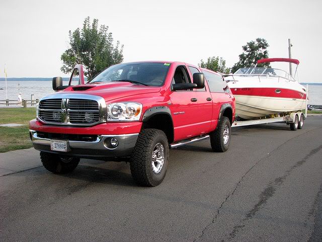

Originally Posted by AF_HEMI
I hope you can prove me wrong Rubber, but im nearly positive the low side flows less cfm than the stock clutch fan. the high side flows much more though. and trust me... if he does any kind of towing in real hot weather he might want that high side
I don't have the numbers in front of me, but I have seen them before. I tow all the time in hot and cold weather, and I have never seen my truck get warm. Not once. And I always run on the low side. All the high side does is dim the lights and sound like a vacumn
