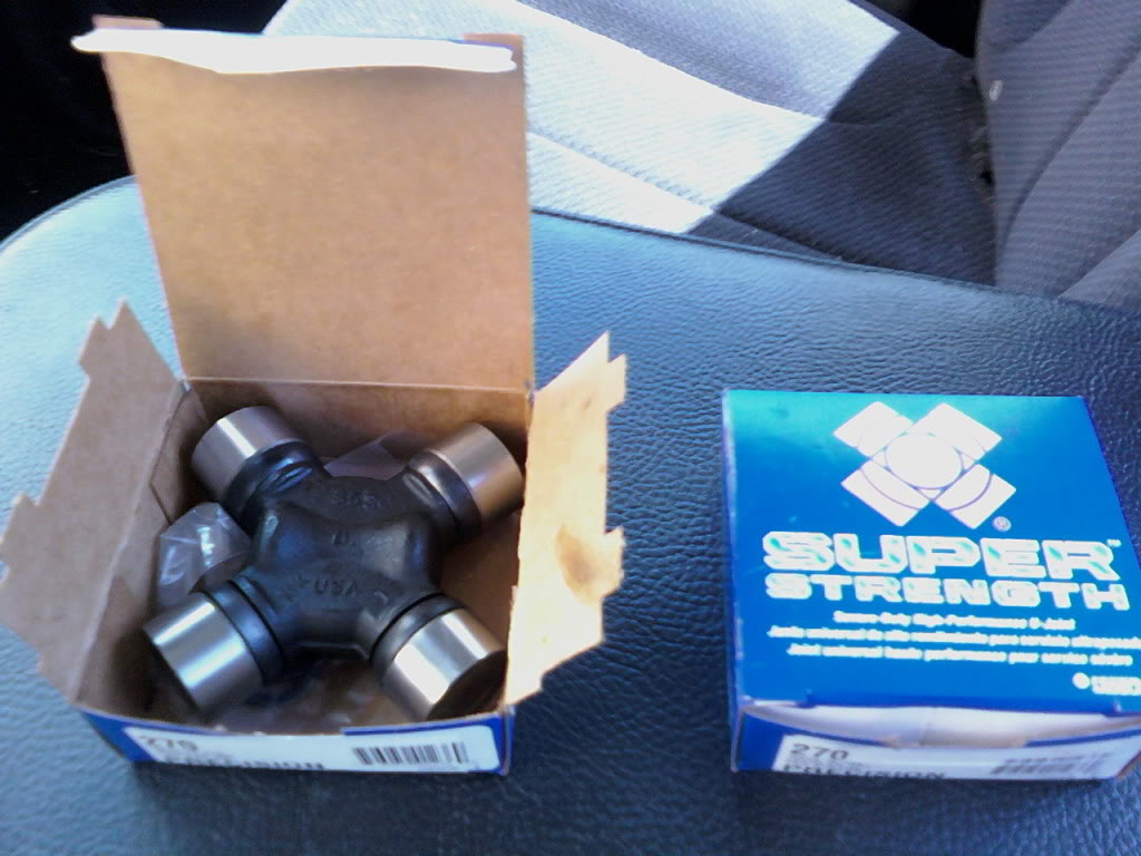

alright guys I went out and got both just to be safe, but just making sure these are the right pieces (I don't really trust oreilly's lol).
I got the ones w the grease fittings
Old Mar 29, 2010 | 03:21 PM
  #36
weedahoe's Avatar
weedahoe
Hall of Fame Member
Posts: 19,168
Likes: 23
From: South GA
those are pretty. Looks like you also need to take a wire brush and some paint you a few things under the truck.....LOL
