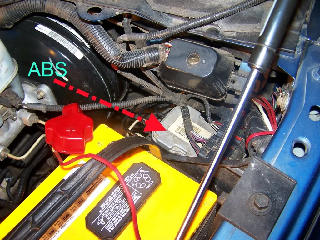

So it's behind or next to the brake resevoir? I'm going to have to go check that, I've never washed under the hood of mine and my ABS acts kinda screwy sometimes. Thanks alot for this post man, some real useful info.

sorry guys.. just got back from the track.. YES.. It is on the drivers inner fender. between the Batt and the Fire wall. Looks like an Alumn brick with 2 brake lines going in. Sorry I couldn't shoot pic's of it since its dark now.
PLEASE REPLY IF YOU FIND THIS SAME ISSUE WITH YOURS....

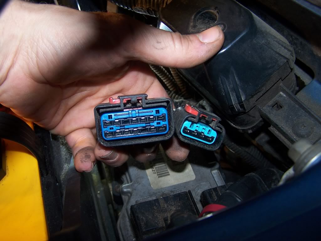

From: The old famed Gen3 Broken Valve Spring Thread - https://dodgeforum.com/forum/3rd-gen-ram-tech/237316
Here ya go......
This is what I found in my wiring harnesses. Nothing.. Yay! Look nice, dry and clean, thank God. OP, thanks for the heads up.

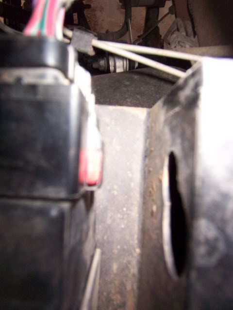

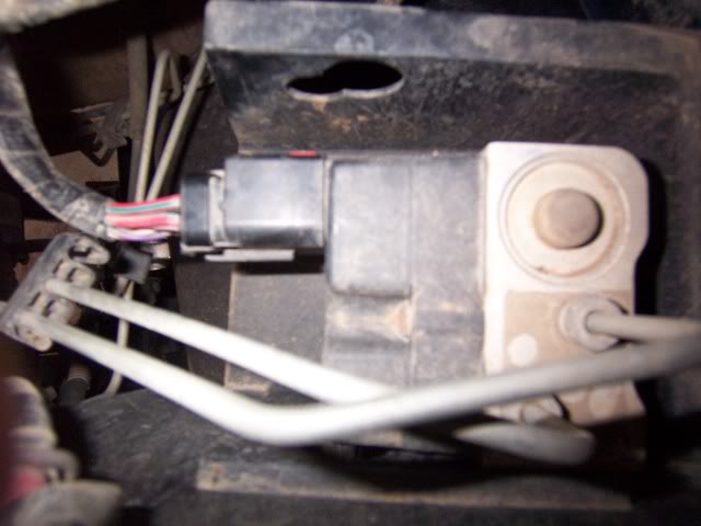

Mine is much more of a pain, I'm sittin outside tryin to brainstorm how to remove this damn plug without breaking it.

Shiloh,
Can't tell but it looks like there is one of those red/orange locking tabs on your plug. That needs to be slid over which will "unlock" the plug. Even after mine was unlocked, I had to depress the black tab with a screwdriver and after a few attempts the plug came off...it was on there pretty good. Just be careful not to pull on the wires.
