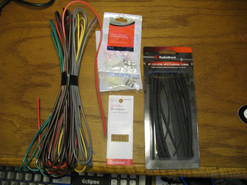

Parts used:
5-Pack 2.2k Ohm resistors - $0.99
2x Electrical connectors - $3.98
a foot or so of 16-20awg wire
Heat Shrink tubing - $3.99

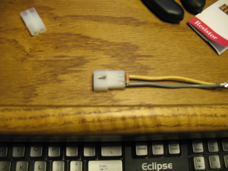

Cut two 6" lengths of wire. Strip the ends/tin them. (note, soldering the connections is optional, but highly advised). crimp/solder on the male prongs onto one end of each wire. On the other end of the wires, crimp/solder on the female receptacles and the 2.2k ohm resistor bridging the two wires together. your end result should look like this:

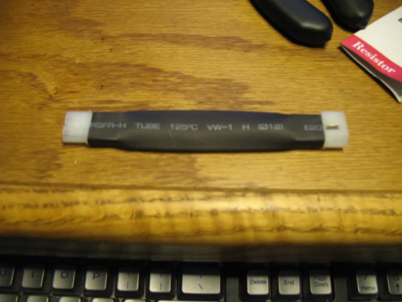

Cut heat shrink tubing to length. Slide over wires and connector. Insert male prongs into male connector.
Step Four:
Use heat gun to shrink the tubing. this is what we will be wiring into the line pressure sensor on the tranny.

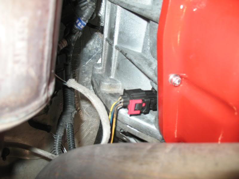

Step Five:

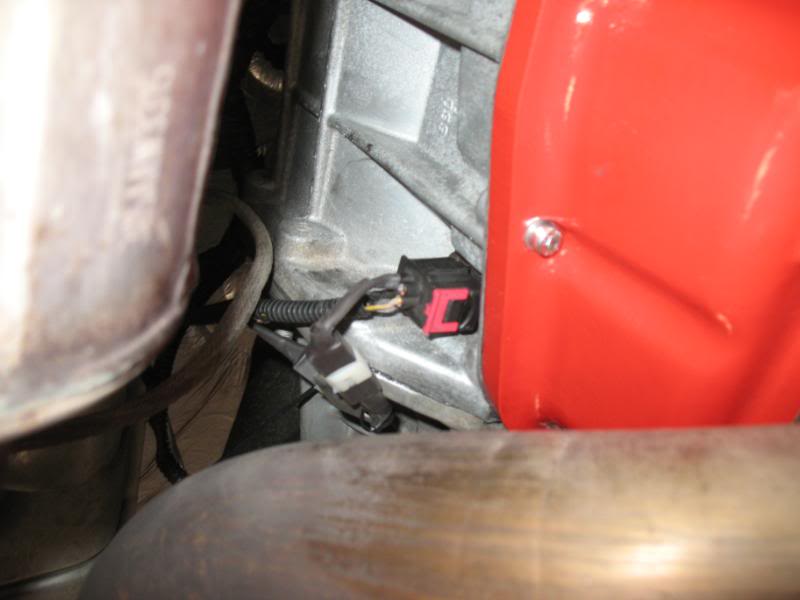

Locate and unplug the line pressure sensor. It is located on the rear passenger side of the tranny.
Step Six:

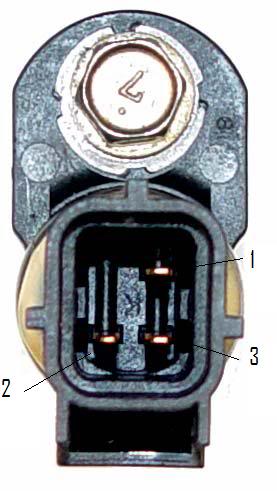

Locate the two wires on the sensor you will be working with. The sensor uses 3 wires, the two that are one on top of the other towards the front of the vehicle are the ones you want. wires 1 and 3 in the following pic.

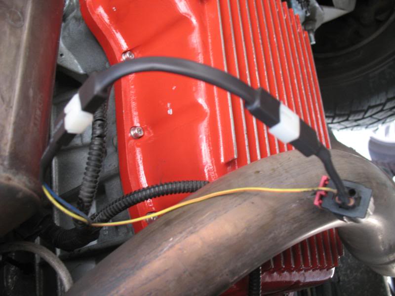

thats it! you are all done. now you can plug the resistor connector we made earlier into your new connectors on the sensor. or if you want to take it out, just plug the 2 connectors into each other, and you are back to stock.
and here it is, plugged back into the tranny with the resistor in place.
