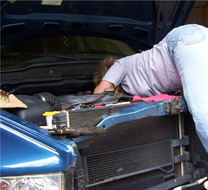

Yep, a 3 & 6 extension and a swivel......AND a wife willing to get the #7 cyl. plugs behind the brake booster.... (Save the comments boys) Get yourself one of those strong extention magnets also for next time. You think these plug changes are annoying, try it on my 99 LS1...even worse. The engineers of those motors and engine bays purposely placed many sharp things in there. Everytime I do the plugs, my forearms look like I just came home with a rabid kitten. Glad ya got it OP.
I want to know if she new you were taking the pic and has she seen it?
Of course! Why would you ask that? Man, she is awesome when it comes to helping. I'm gonna edit that because you're getting the wrooooooong idea here.
