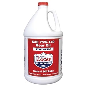

Originally Posted by dodgegirl05
im all angle!! lol jk
i got lucas diff oil! anyone use that?
Thats what I am going to use, along with the Mag-Hytec covers when I change mine out. Keep in mind that the rear diff requires the Synthetic (red label) version, the front doesn't care (dino or syn)
The Lucas supposedly also has the LSD additive as well, so hopefully nothing else will be needed.
