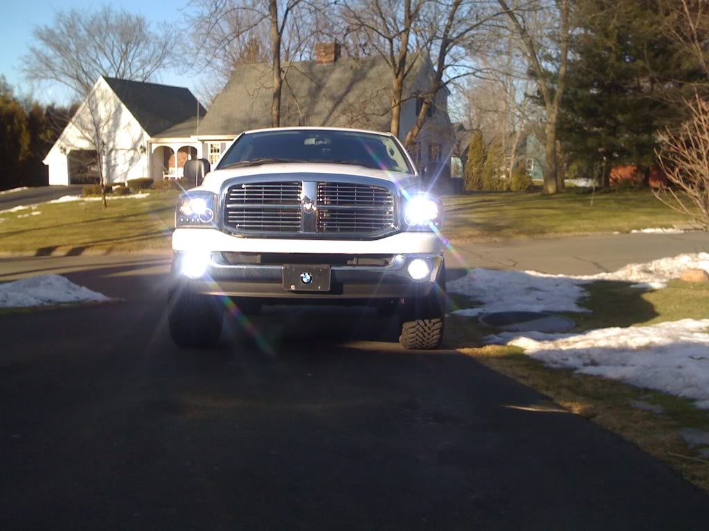

probably the wrong bulb since the stock bulb isnt the same as the projector. i had hids in mine.

well for some reason this posted twice... i think i pressed enter on accident. but i had the right bulbs, it was the h1 kit that i ordered. Those look awesome in the projector.
