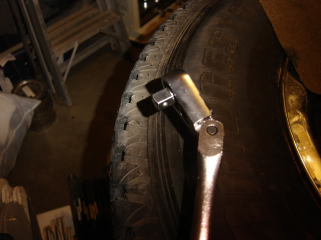

go to sparkplugs.com and use DT10PLGS and type in all the info and they give u right gap if u need plugs. as far as tools, i used 5/8 socket with a 3 inch extension. i picked up a ratchet where the head moves for different angleName:  random032.jpg
