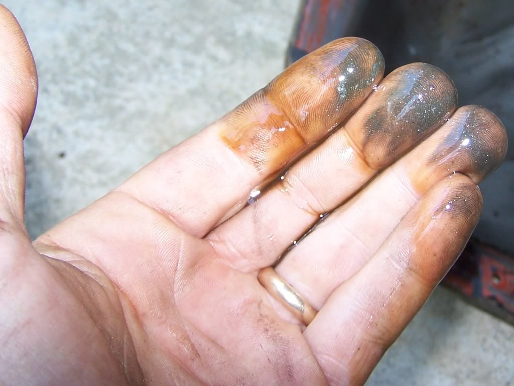

OMG Al...sigh....this sucks. This puts me in a very stressful situation. I have to drive it, I must work and I surely can't afford a new LSD right now. Thank you for the information....I think. So they are in there ONLY to "aid" in the installation and should have been removed after assembly by the factory is what you are saying? So, in my other pic is one of them, how do I access the other 4? I don't recall seeing them.
What's the cost of replacing with an Auburn/DTT...does it have to be done by a shop? I'm clueless on rear ends. and...uh...you mentioned fine metal particles? I just so happened to take this pic also....from scraping my fingers across the magnet.

As Weed said FireFighter.............it's a real crap deal when this stuff happens and it happens regularly, at that with these totally crap LSD's.
OK on to your problem.
I take it that your not under any warranty? If so, read on, otherwise take her in and get them to spend their money and time.
The clips can be removed. You must do this ASAP. Open the diff and drop that fresh oil. It's useless anyway, as it's now probably contaminated with fine metal bits.
You can run without the clips, I guarntee at least 20K miles as I did with my diff.
The clips are there as many people believe, to aid the initial installation of the clutch pack. The factory leave them in, as it's probably more cost effective to do so than to take them out.
Take the clips out by any safe means, as that will give you time to save up and get a DTT or Aurburn.
It looks to me unfortunately, like one of the clips is starting to cut into the carrier/bearing caps as mine did, as there are "sparklies" in your oil as evidenced in your excellent last pic.
You will have to flush out and clean all your axle, gear sets and such. Being from the UK, I don't know any of your product names you could use to do this, but someone on the board will chime in...................please?
I used a light parafin based solution, to clean everything up. Use lots and lots and make sure all the old oil and crap are gone. Do a "white glove test" like they do in the military for dust and stuff. No sparklies or dirty oil should be left at all. Continue cleaning untill you get to that stage. Any left, will only contaminate your new oil and ruin all your efforts.
There are 4 clips in the clutch packs. Put your truck on axel stands and turn the driving wheels and look into the open diff.
You should see the 4 pockets near the left and right side gears deep in the internals of the gear sets. One set of two retains the left side clutch pack the other two the right.
You have got to remove these clips or at least, ascertain that the clips are at least complete if so, if you can't get them out, leave them in.
They will however over time, have the same problem of the ends snapping off, so if you can get them out now, all the better and every effort should IMHO be made to do so.
Once everything is clean and you have either all the clips out or found the remaining clips are intact, button the axle back up and refill. You have done all you possibly can to temporarily sort this mess out that you can do for now.
I would however, set aside both time and money to get a complete new LSD install in the future and religiously check on the remain gclips if left in, when you do an oil change every 15K.
Hope this helps and good luck as you certainly have had a bad run of late.

Tim, there is no reason to think the ring and pinion are shot....yet. Now if you get a false security in that the diff is still quiet and keep running with clips in there and particles in your fluid - it will be.
I went to an Auburn LSD (and yes DTT is the Detroit TruTrac LSD) at only 19k miles, so I didn't have it happen to me.
I am not aware of any specific product made to "clean out" the pumpkin. But a good brake cleaner should do the job. Be sure to completely wipe the inside out with a couple of rags.
If it were me, I'd make sure I had all the clips and residue out and do exactly what Al did and run with the stock LSD for a while. This will buy you time to find out if the gears and/or the carrier has been damaged. At $300-400 labor to set gears or install a new LSD, you do not want to have to pay it twice. The labor involved is quite redundant for both and most shops will not charge much more (if anything at all) to install a LSD if they are already doing the gears. 4 Wheel Parts installed my LSD for free provided I bought the LSD from them and had it done at the same time as my 4.56 gears.
At some point, if the rear end appears to be sound, I'd still get the LSD out of there, even though the troublesome clips will be gone, the stock LSD is a non-functional POS! Even when working correctly, the bias ratio is **** poor and often requires you to depress the brake or apply a slight amount of e-brake just to get it to function at all.
